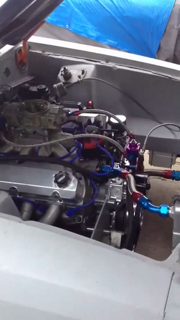

Did some other work needed on the car. Didn't have a restrictor plate in the cooling system so it was getting up to 200 degree's when I was down at E20 2-weekends ago. Made a restrictor plate and pulled the cooling fans into the engine compartment to pull the fresh air into it. Didn't test this until today and had great results, with the pump on it got to about 190 degrees. I then turned on the fan and almost instantly dropped to about 185 degrees and kept dropping, didn't even think about getting any warmer. I am happy with the results.
