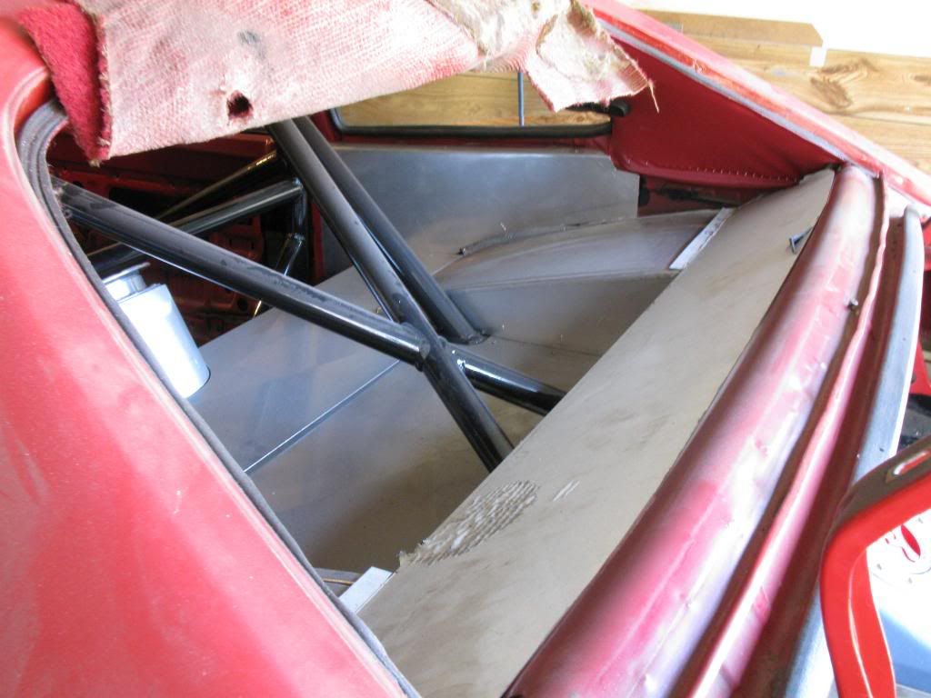

Went with 4 piston Wilwood front brakes and hubs.
http://i93.photobucket.com/albums/l5...1-21-20109.jpg
http://i93.photobucket.com/albums/l5...1-21-20108.jpg
5 gallon fuel cell, Weldon pump, with pre and post filters. Rear trunk area has a full bulkhead to separate from driver compartment.
http://i93.photobucket.com/albums/l5...-21-201016.jpg
http://i93.photobucket.com/albums/l5...-21-201015.jpg
All aluminum interior, super lightweight. All custom made. G-Force GF5R trans. Long shifter.
http://i93.photobucket.com/albums/l5...-21-201011.jpg
http://i93.photobucket.com/albums/l5...-21-201012.jpg
http://i93.photobucket.com/albums/l5...-21-201013.jpg
Old picture, but shows the trans setup pretty good.
http://i93.photobucket.com/albums/l5...te11-5-082.jpg
Footwell area. Mechanical linkage throttle, with fairly firm return spring. Mechanical brakes, mechanical linkage clutch to a McLeod Soft Lok clutch.
http://i93.photobucket.com/albums/l5...-21-201014.jpg
Old pic, but decent shot of the linkage
http://i93.photobucket.com/albums/l5...te11-5-086.jpg
3.5" exhaust dumped right at firewall.
http://i93.photobucket.com/albums/l5...1-21-20106.jpg
Rear end setup is a 9" setup, 4-link with wishbone locator.
http://i93.photobucket.com/albums/l5...1-21-20107.jpg
