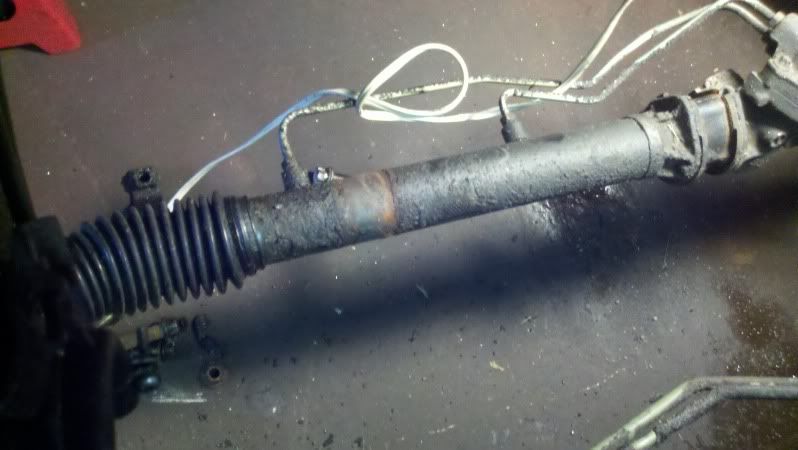

Ok so here is the build thread, most of the actual engine work is going to happen this weekend. Should be getting my harness in, get the steering rack swapped over to one with the mounts pre-fabbed, and possibly get the motor in the car. Here is the car as it sits, minus the exhaust and interior
