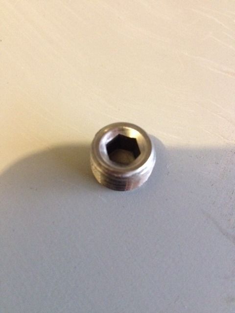

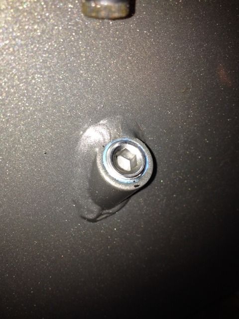

So, as for everyone that was at E20 on Friday. They know that I had a technical issue that caused the car to smoke while going down the track like a freight train on my second pass. Well, after some evaluation with my brother, here is what we didn't find keeping the oil from under coating the entire car and components!
Not happy about it, but at the same time I thank God that worse things didn't happen as a result from this!

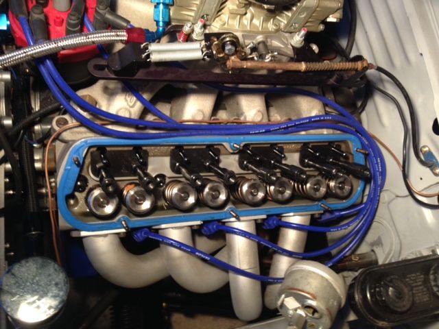

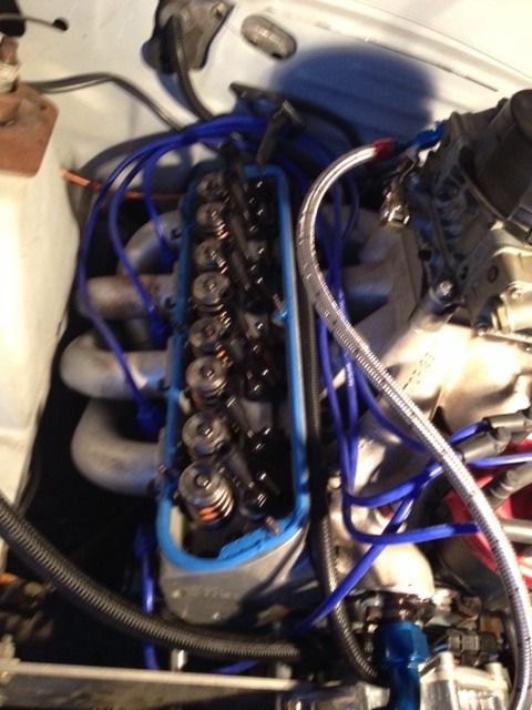

Most of you don't know but I have been chasing an excessive valvetrain noise that I just couldn't figure out. This is one reason for being so nervous to make that first pass down the track, as most could tell, Lol. I decided to pull the valve covers again today just to give things a once over again. I started checking the rocker movement and to my surprise I found excessive movement between the rocker itself and the trunnion. I'm going to call Comp Cams tomorrow and see if they still offer the rebuild kits for these rockers. I also have a charging system issue, had the 1-wire GM Delco Remy alternator tested at J&N Auto Electric and they said it was good. So I'm going to replace the battery being it is a couple years old and see if this helps, I was only able to start the car 5-6 times and then it was dead. I guess that's to be expected with the new build jidders.

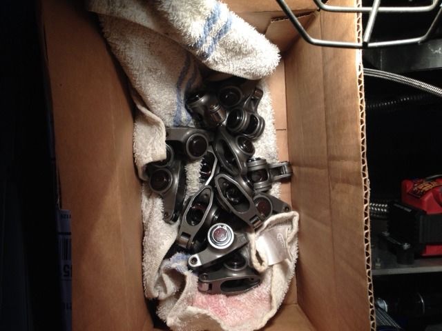

Going to pull the rockers off today as well and get them sent out to Comp Cams.

Now it's time to remove the rockers,2-3 weeks to get them back.
