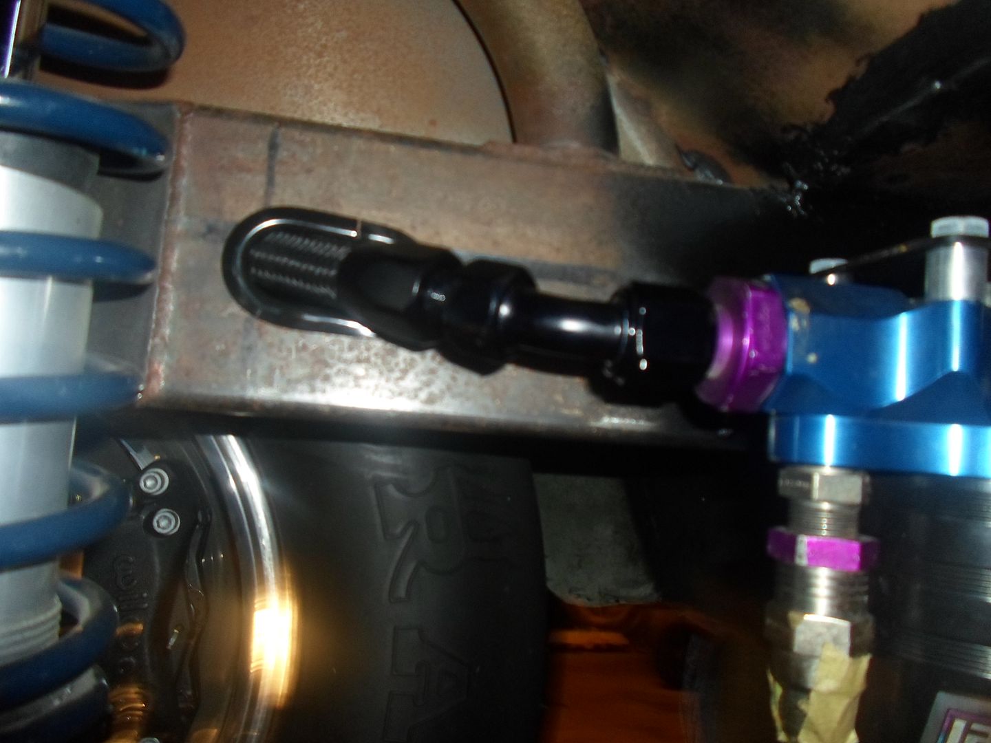

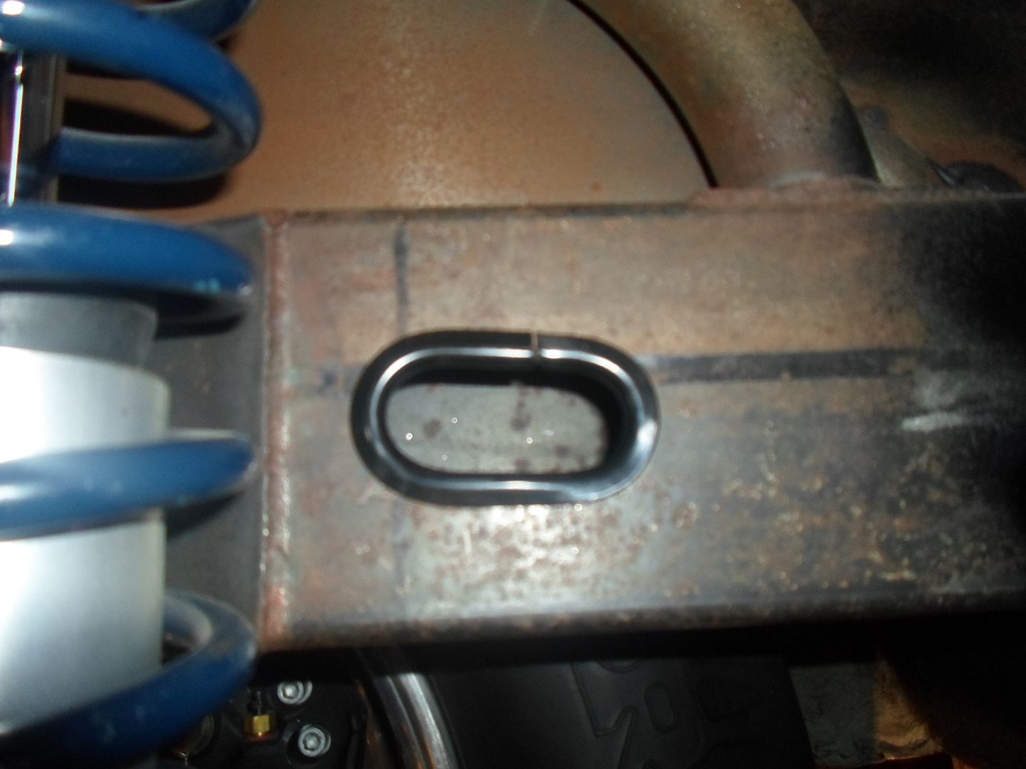

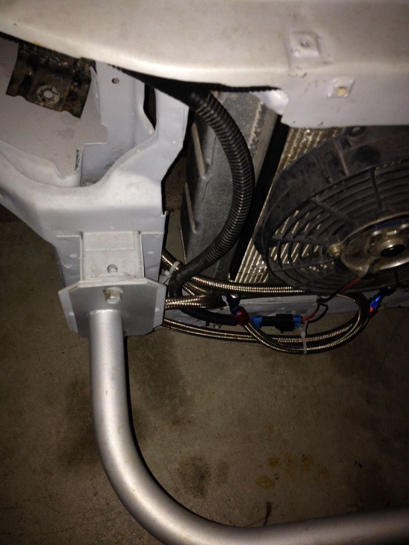

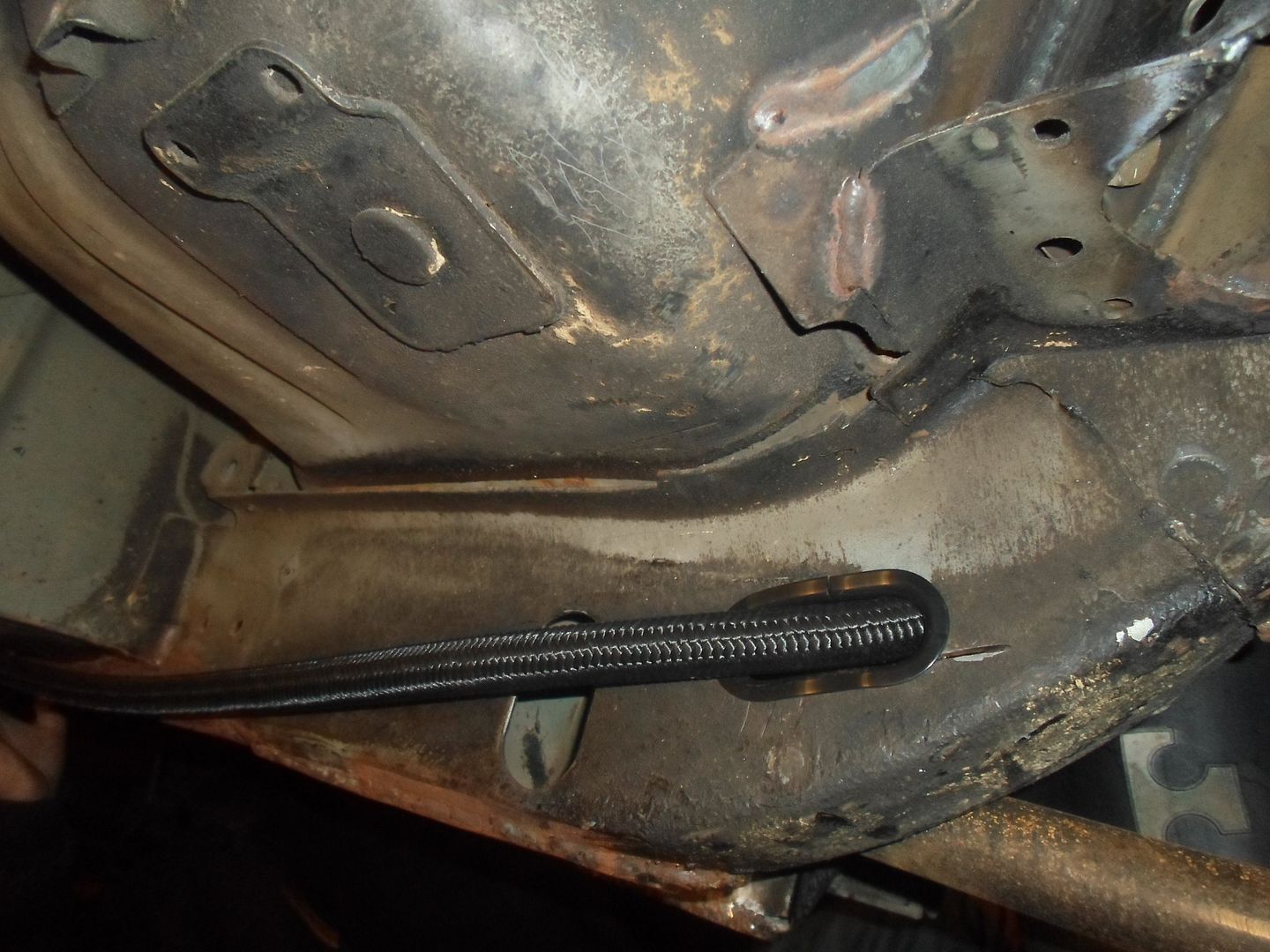

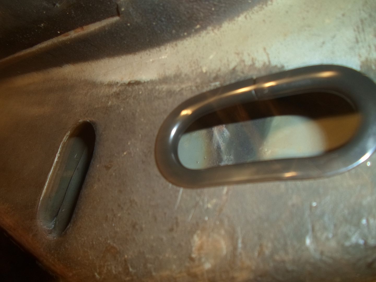

Took the fuel lines back out last night from the frame rails. I then installed automotive edge trimming to insure I shouldn't have any issues with abrasive wear or cutting the fuel line under heavy acceleration. LOL
http://i1096.photobucket.com/albums/...ps7cf37495.jpg
http://i1096.photobucket.com/albums/...ps612c53b2.jpg
http://i1096.photobucket.com/albums/...ps68cbea15.jpg
http://i1096.photobucket.com/albums/...ps7ca04ada.jpg
Looks good
SWEET !!! Grommets are Good ... I know a guy you should explain those to !!! LOL
That's another funny comment you've come up with, I appreciate the compliment.

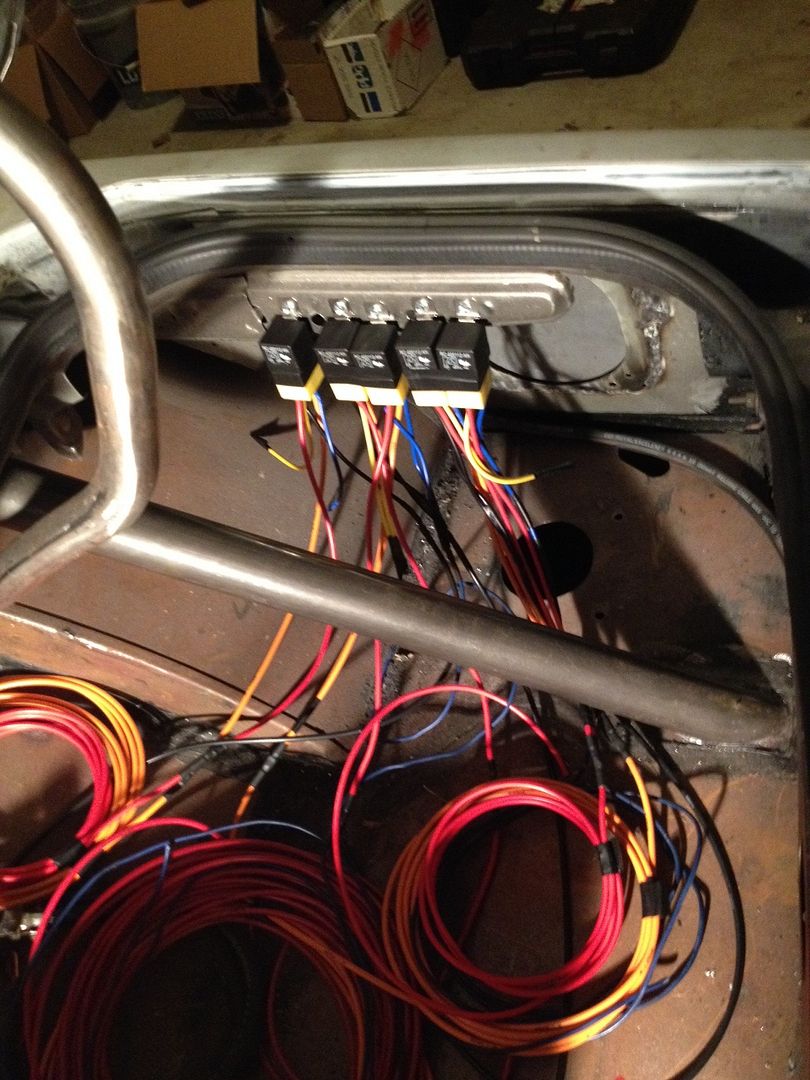

Here is just a simple photo of the relays I wired up for the Magnafuel fuel pump, Meziere electric water pump and the dual electric fans at this time, one step forward is a plus.
http://i1096.photobucket.com/albums/...psfixfynil.jpg
Now I will run the wiring up in the car to the switches mounted in the passenger side kick panel area.
Looks good an looks like u gonna need a lot of wire for this job lol
Yeah, definitely going to need a little bit of wire. Fortunately I can get all that I need for it.

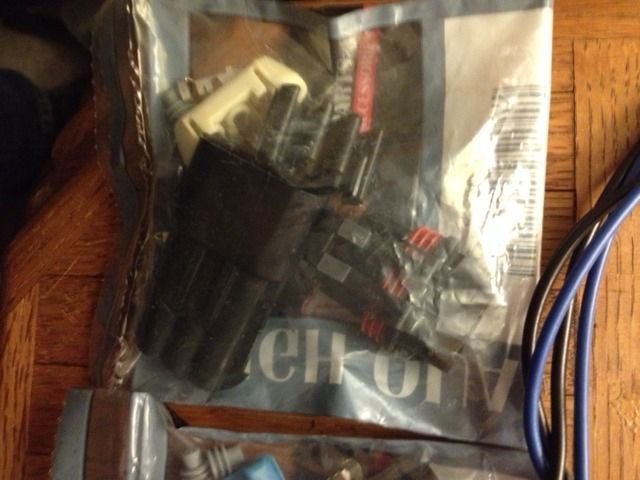

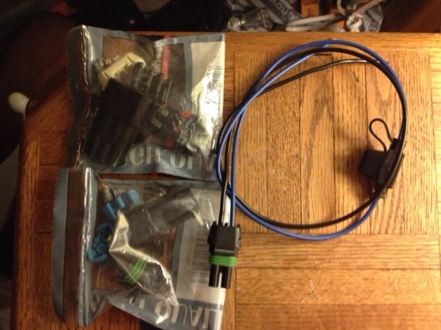

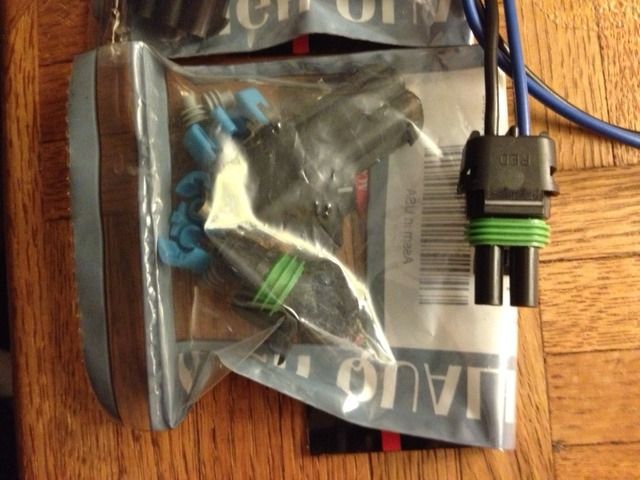

Went and got some Delphi weatherproof disconnects to wire in the fuel pump, electric water pump and cooling fans.

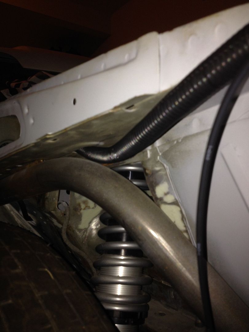

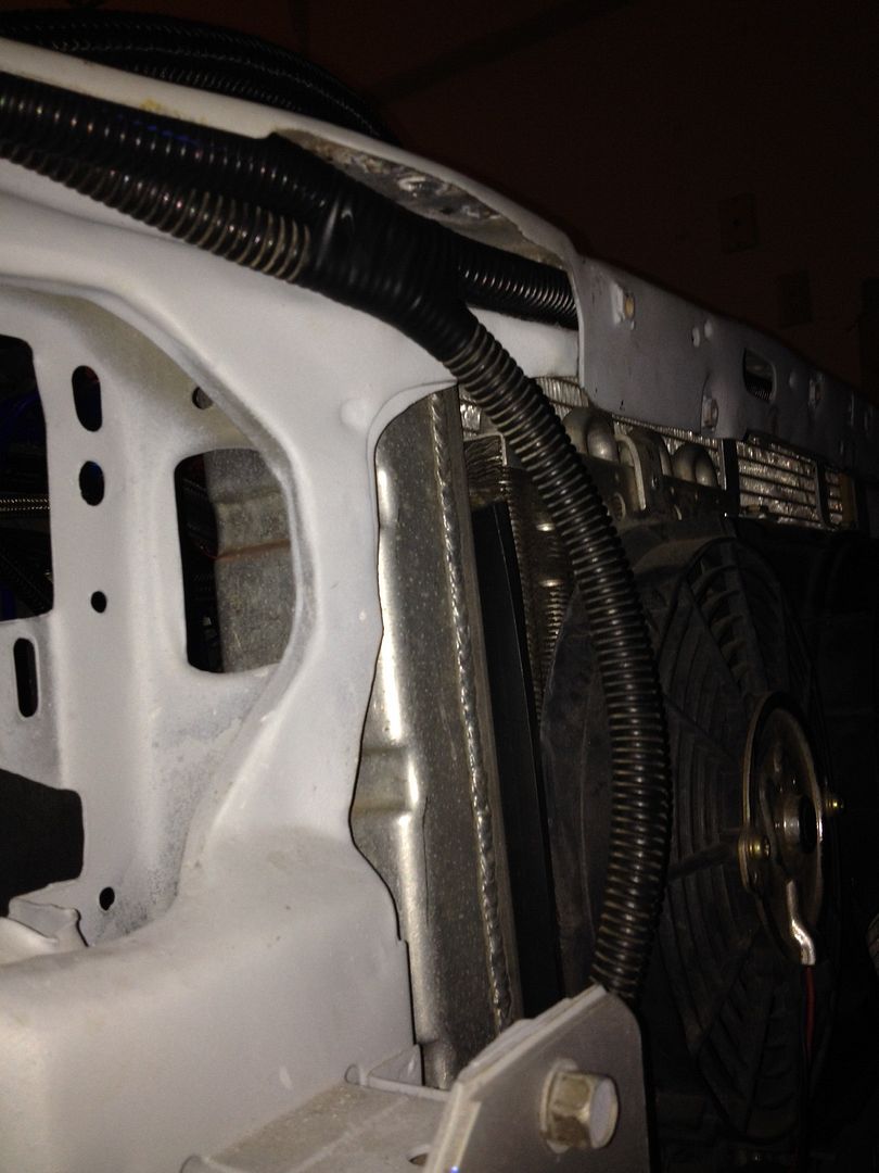

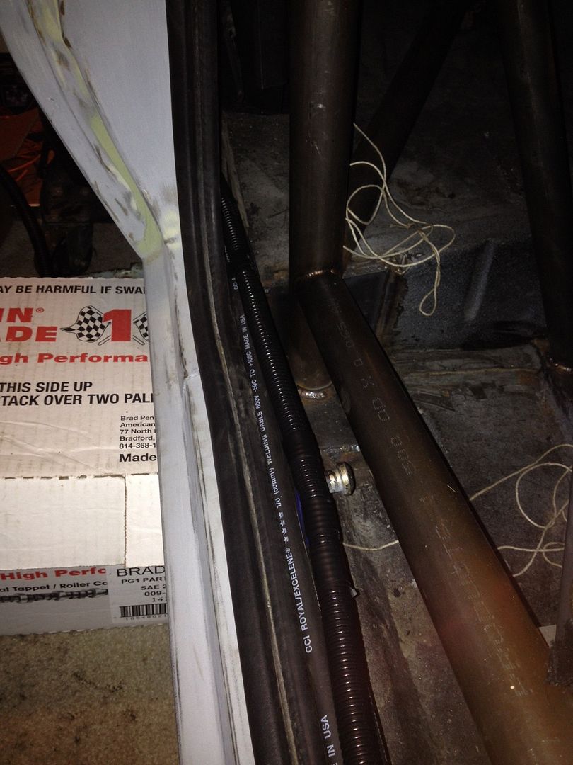

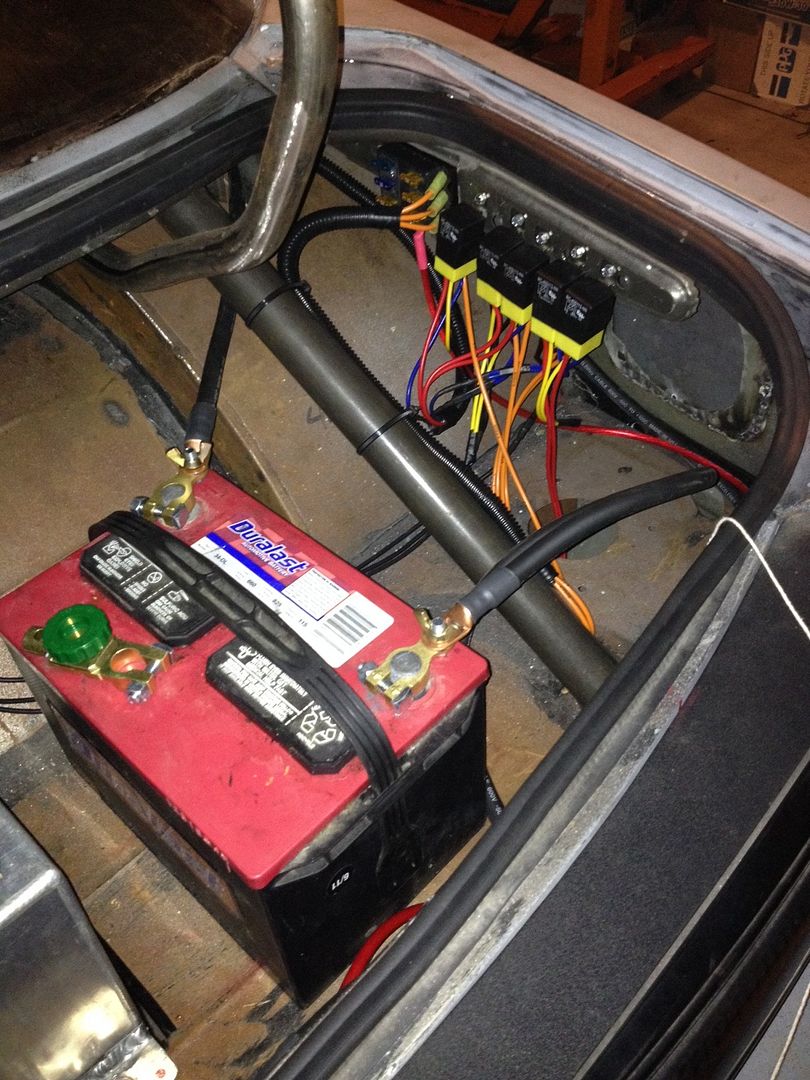

Cleaned up the wiring in the rear from the relays and fuse block and running everything as well hidden as possible.

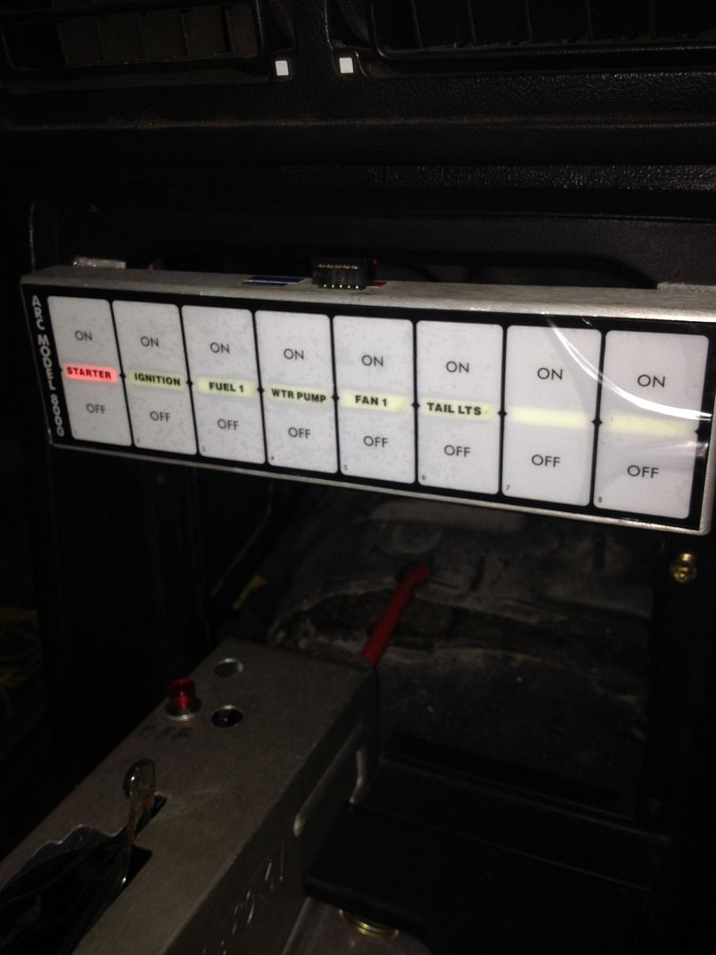

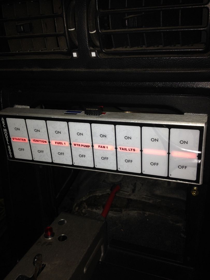

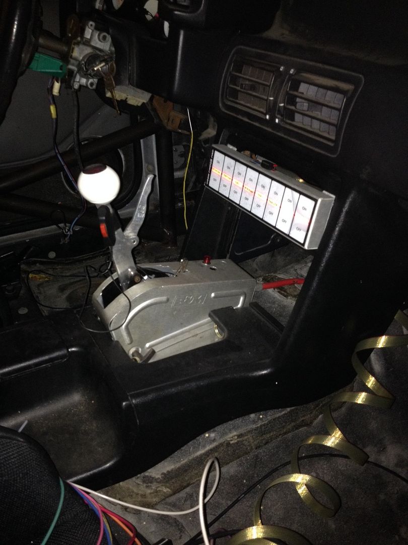

Had some issues with the ARC 8000 switch panel but it seems to be working now.
http://i1096.photobucket.com/albums/...psfis6jwrc.jpg
http://i1096.photobucket.com/albums/...psqot0fz2a.jpg
http://i1096.photobucket.com/albums/...pszvxvymsf.jpg
http://i1096.photobucket.com/albums/...pse58zagff.jpg
Looking good! I really like those ARC controls setups.
I agree Rick, their switches and and the relay panels being prefabbed make them nice and easy to use.

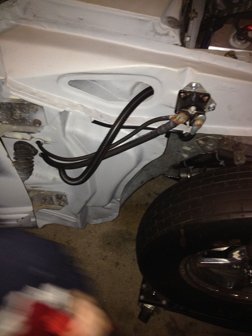

Made some more progress today, no pictures but I did accomplish to get the fittings needed for the oil pressure gauge from the block and the 90* elbow I needed for the fuel pressure gauge off of the regulator all hooked up. Have the wiring from the starter solenoid to the starter finished as well. I'm going to put oil in the engine and pull the spark plugs to turn it over by the starter switch, it should go well and show me some oil pressure prior to starting it. If all goes well, I should almost be in the position to start the car this weekend, I say almost because I do not have any fuel or the exact plugs needed but that is a minor detail. Lol

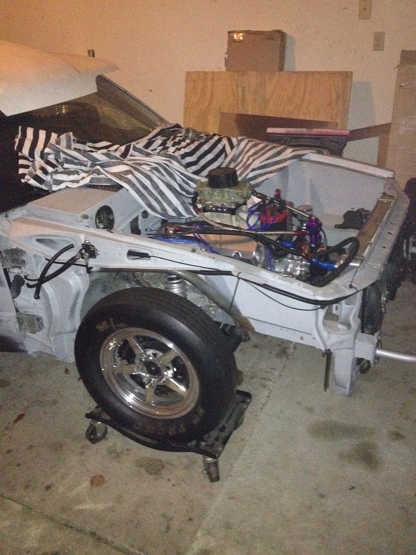

Just finished plumbing the fuel system other than a couple mounting pieces, that means it's one step closer to being finished.
Good, when's the fire up date?
